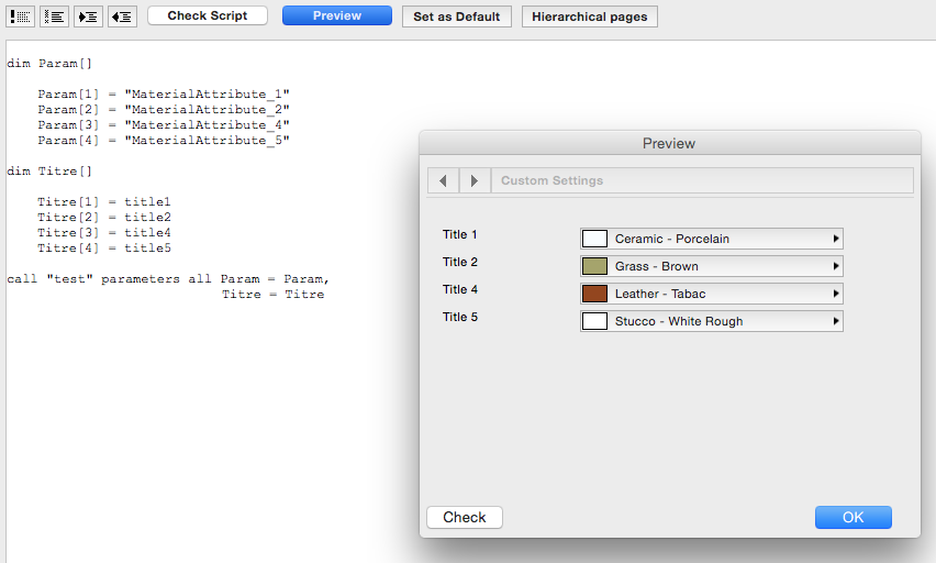

Instead I would recommend the following solution:

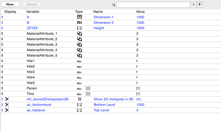

Create the Param and Titre arrays as a dynamic array parameter in the macro. Also all the string and material parameters you would like to handle in your macro.
When you call the macro from an object create the arrays in the User Interface script with the DIM command and fill them up with the surface parameters you would like to display. In the macro, loop through the array, until its dimension. The dimension should be given by the caller object.
MACRO:
! Loop through the array until the actual array dimension given by the caller object
for i = 1 to vardim1(Param)
UI_OUTFIELD Titre[i], 15, i * 25, 120, 20
UI_INFIELD{4} Param[i], 140,i * 25, 240, 20
next i
CALLER OBJECT:
! Arrays in the caller object for the macro, filled with the parameters used by the caller object
! The actual dimension of these arrays is given by the caller object (below)
dim Param[4]
Param[1] = "MaterialAttribute_1"
Param[2] = "MaterialAttribute_2"
Param[3] = "MaterialAttribute_4"
Param[4] = "MaterialAttribute_5"
dim Titre[4]
Titre[1] = title1
Titre[2] = title2
Titre[3] = title4
Titre[4] = title5
call "ui_surface_macro" parameters all Param = Param,
Titre = Titre
