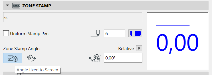

This global isn’t set for zone stamps. The stamp is rotated by AC, it has a setting for this, see attached picture.
