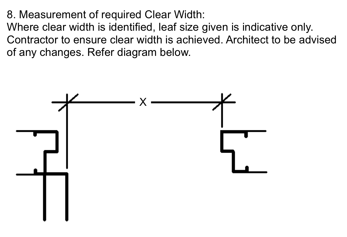

As some of you know, egress dimension in the standard GS door does not comply with egress standard in AUS.(nor Local version of ARCHICAD does not report correct value as well.)
What I am after is clear width dimension for DDA drawings where the width is measured as per diagram in the attachment.
I can set the calculation to take leaf width as variable (egg if leaf_width > 1200 then leaf=2) but it would be much reliable to have calculations based on the true information.
