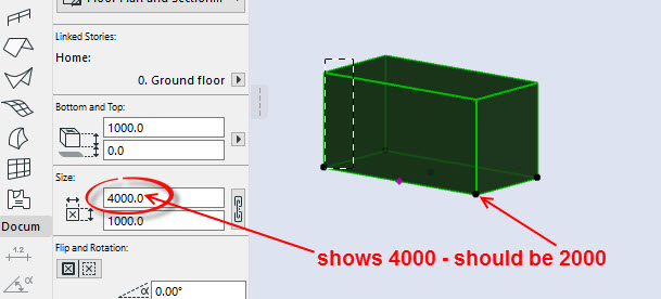

This is the best I can come up with at the moment – need to get back to real work!
values "flip_switch" 0,1
n = APPLICATION_QUERY ("parameter_script", "firstoccasion_in_progress", isFirstRun)
if isFirstRun then
if flip_switch = 1 then
A = A + 1
PARAMETERS A = A
!! flip_switch = 0
!! PARAMETERS flip_switch = flip_switch
endif
endif
This is what you need in the parameter script.
Delete what you have in the master script.
This works in 3D but you have to reset the hotspot to zero your self.
Odd thing is the info box increases by 3000 but the object shows correct at 2000 (see image).
If you open the settings dialogue it will increase another 1000 to 5000.
Not sure what is going on there.
If you in-comment the two lines in my script then it all works perfectly but the hotspot does not stretch any more as it is obviously being reset before the object adjusts.
But changing the parameter in the settings dialogue works.
This may give some help or maybe someone else has some better ideas.
