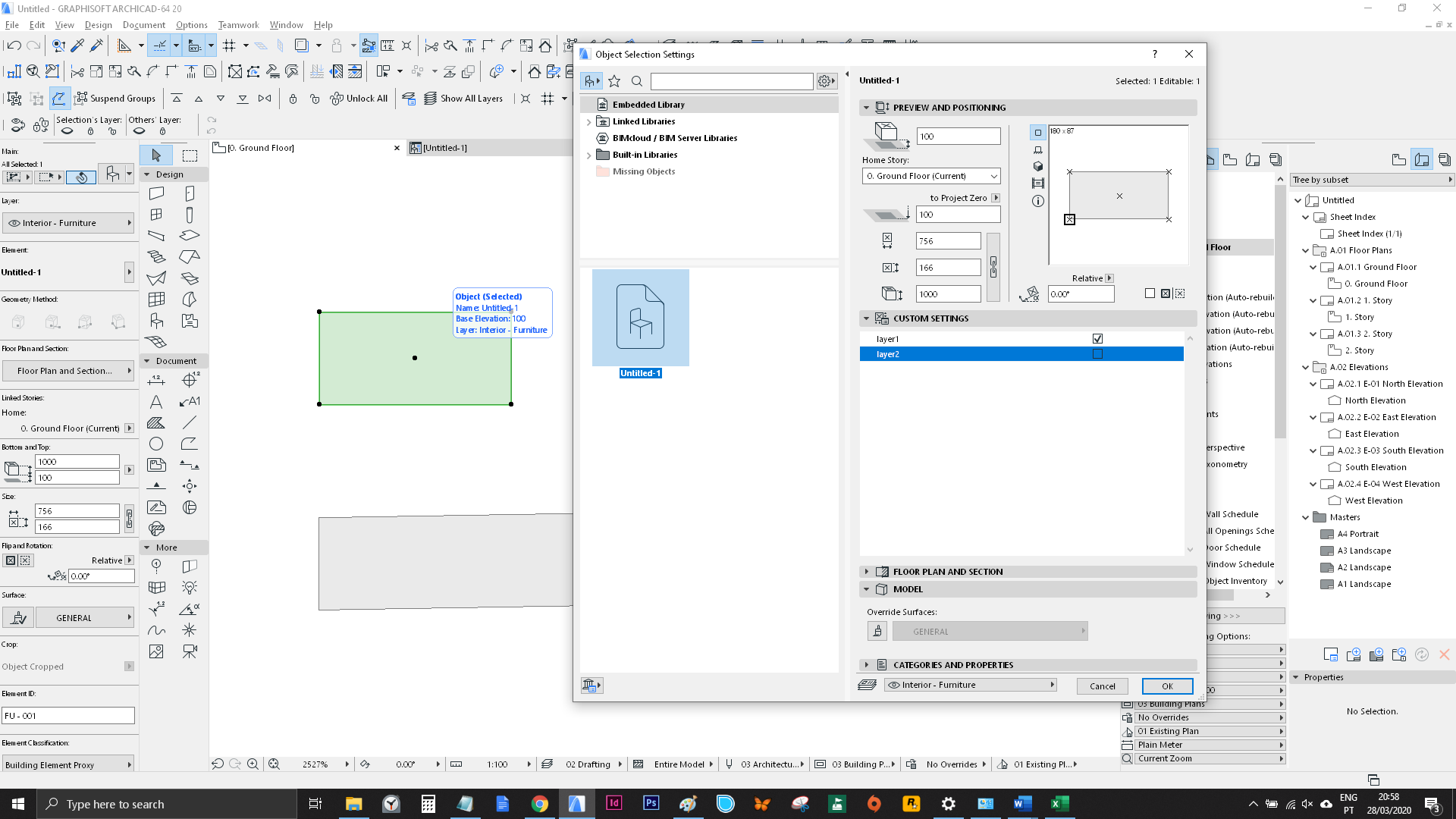

    Hey guys,
    I draw a lot in the 2d symbol putting things in different layers and using code like
    IF layer1=1 THEN
    FRAGMENT2 1,0
    ENDIF
    for every layer so I can turn things on and off.
    The problem is the values of A and B don’t adjust automatically. I activated the “FIT size to 2D symbol” and the “create a bounding box”(compatibility options).
    in layer 1 there is a box of 100 X 200
    in layer 2 there is a box of 300 X 800
    Archicad makes a perfect bounding box depending on the layer but the values of A and B are entire layers limits so they end up being always A=300 B=800.
    Any code that i can make the A and B values= bounding box?
    Thanks in advance
    luis
