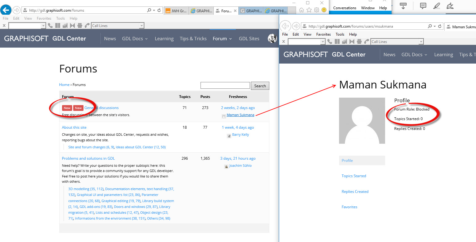

Dell Precision M6800 - i7 4700MQ @ 2.40GHz, 16GB RAM, AMD FirePro M6100 (2GB), Windows 7 64bitBarry KellyParticipantA couple of weeks ago, ‘Maman Sukmana’ posted a few spam posts.
His profile has since been blocked and the posts deleted, but they still show as ‘NEW’ posts in the forum.I managed to read one before his profile was blocked, so that has gone (for me), but two still remain.
As we can not mark them as read, and of course can’t open them as they have been deleted, could admin please delete this user for good and/or clear these ‘NEW’ posts?
See attached image.Thanks,
Barry.Attachments:
