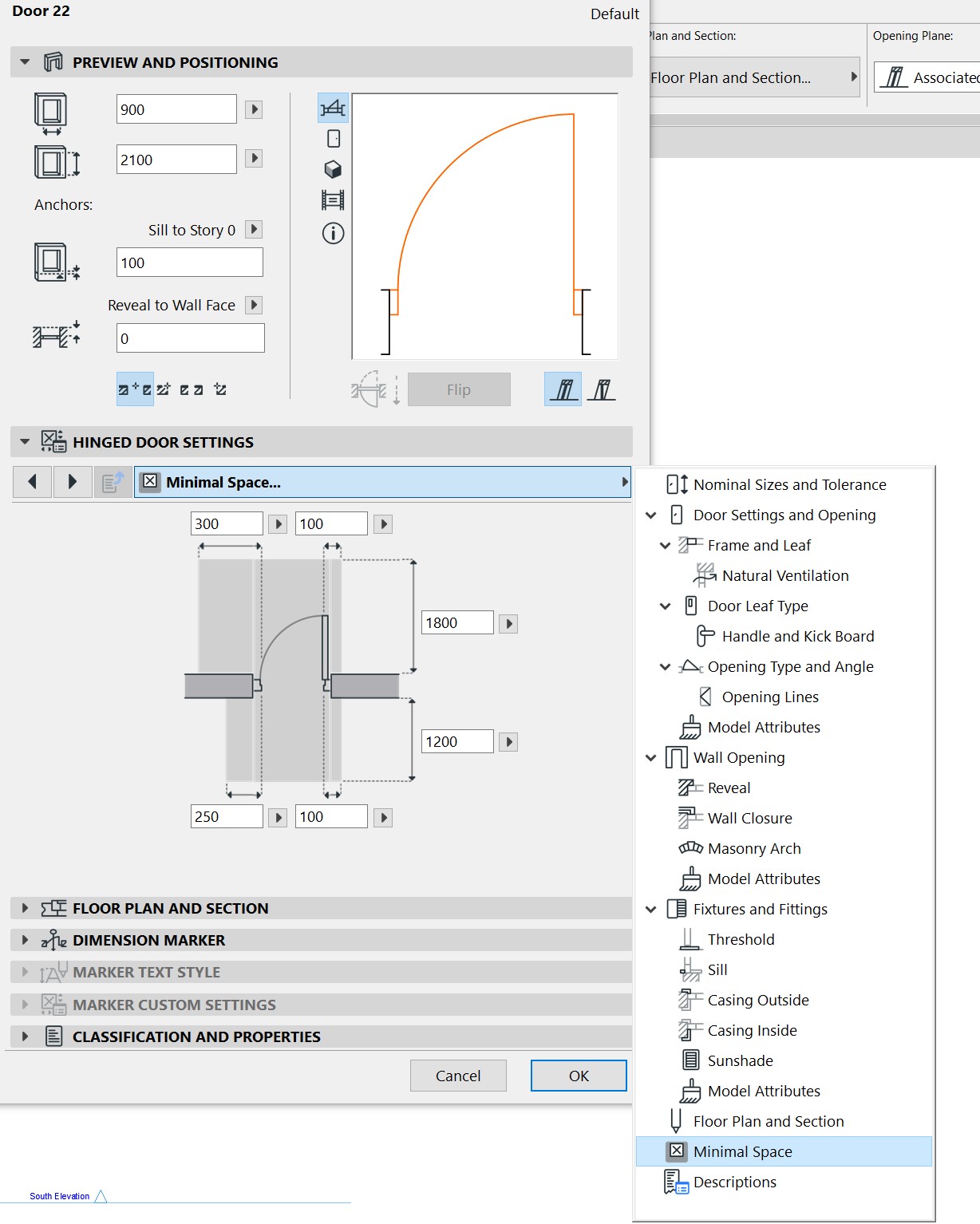

KeymasterHi Chris,
If you open the object editor and change the parameter values, that only affects the default values of the object (door, window…). To edit the values of a placed instance, open the settings dialog, go to the graphical ui part (Hinged door settings in most of our doors), and search for the minimal space tabpage (usually second from bottom) – there you’ll find all relevant parameters for minimal space.
