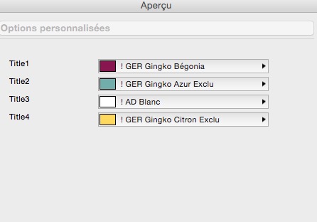

ParticipantHi, i want to list in interface page object some material parameters, but i want to mask on parameter if this one is not allow to changein my object (hide in box parameter or material = 1).
When i put if, it doesn’t work … why ?
dim Titre[4]
Titre[1] = “title1”
Titre[2] = “title2”
Titre[3] = “title3”
Titre[4] = “title4”dim Param[4]
Param[1] = “MaterialAttribute_1”
Param[2] = “MaterialAttribute_2”
Param[3] = “MaterialAttribute_3”
Param[4] = “MaterialAttribute_4”i=0
WHILE i <= 3 DO
i=i+1!if Param[i] > 1 then
UI_OUTFIELD Titre[i] ,15,i*25 ,120,20
UI_INFIELD Param[i] , 140,i*25,240,20
!ENDIFENDWHILE

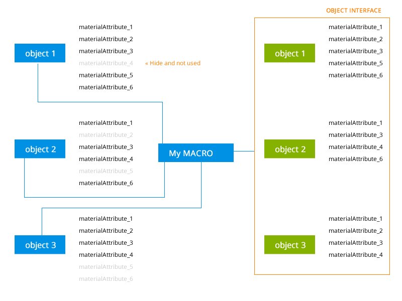

MemberHi Tonio,
On what kind of condition would you like to display the infield-outfield pairs?
Would you like to display the parameters on every condition, and instead lock the parameter which does not take effect? (As on the attached image)Attachments:

Yes i would like to lock it or better I hope it does not appear and be replaced by the following – it’s in a macro apply on many product…
Tonio

ParticipantI am checking if my Shader variable is equal to 1 or is hidden, if that’s the case I do not want to display it
Tonio

Participantprogram update
dim Titre[5]
Titre[1] = “Tissu extérieur”
Titre[2] = “Tissu intérieur”
Titre[3] = “Accoudoir”
Titre[4] = “Passepoil”
Titre[5] = “Tissu Cale reins”dim Param[5]
Param[1] = “GerMaterial_1”
Param[2] = “GerMaterial_2”
Param[3] = “GerMaterial_3”
Param[4] = “GerMaterial_4”
Param[5] = “GerMaterial_5”i=0
WHILE i <= 4 DO
i=i+1if Param[i] = “1” THEN
hideparameter Param[i]
lock Param[i]ELSE
UI_INFIELD Param[i] , 140,i*25,240,20ENDIF
ENDWHILE
Tonio

ParticipantYes i would like to lock it or better I hope it does not appear and be replaced by the following – it’s in a macro apply on many product…
Tonio

MemberHi Tonio,
If the Surface parameters are handled as strings in an array, it is not possible to check their values. Neither is possible to check whether they are hidden in the caller object.
Instead I would recommend the following solution:
Create the Param and Titre arrays as a dynamic array parameter in the macro. Also all the string and material parameters you would like to handle in your macro.
When you call the macro from an object create the arrays in the User Interface script with the DIM command and fill them up with the surface parameters you would like to display. In the macro, loop through the array, until its dimension. The dimension should be given by the caller object.MACRO:
! Loop through the array until the actual array dimension given by the caller objectfor i = 1 to vardim1(Param) UI_OUTFIELD Titre[i], 15, i * 25, 120, 20 UI_INFIELD{4} Param[i], 140,i * 25, 240, 20 next iCALLER OBJECT:
! Arrays in the caller object for the macro, filled with the parameters used by the caller object
! The actual dimension of these arrays is given by the caller object (below)dim Param[4] Param[1] = "MaterialAttribute_1" Param[2] = "MaterialAttribute_2" Param[3] = "MaterialAttribute_4" Param[4] = "MaterialAttribute_5" dim Titre[4] Titre[1] = title1 Titre[2] = title2 Titre[3] = title4 Titre[4] = title5 call "ui_surface_macro" parameters all Param = Param, Titre = TitreAttachments:
