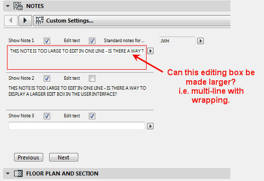

When creating a UI_INFIELD for a text parameter is there a way to make it larger (i.e. multi-line with text wrapping) so that the whole text can be seen when editing.
See the attached image as an example.
Currently I have a switch that changes from UI_INFIELD when editing to UI_OUTFIELD to display all of the text (UI_OUTFIELD can be multi-line).
That kind of control does not exist in GDL. Your current solution is the best you can do: making the infield as long as possible, and adding a display outfield.
The only infield with multiline capabilities is the checkbox-boolean type, but it’s not eligible for text input, only description output.
Thanks Dominika,
I thought that was going to be the answer but I was hoping there may have been something I wasn’t aware of.
Maybe it could be added to the wish-list of GDL improvements please?
