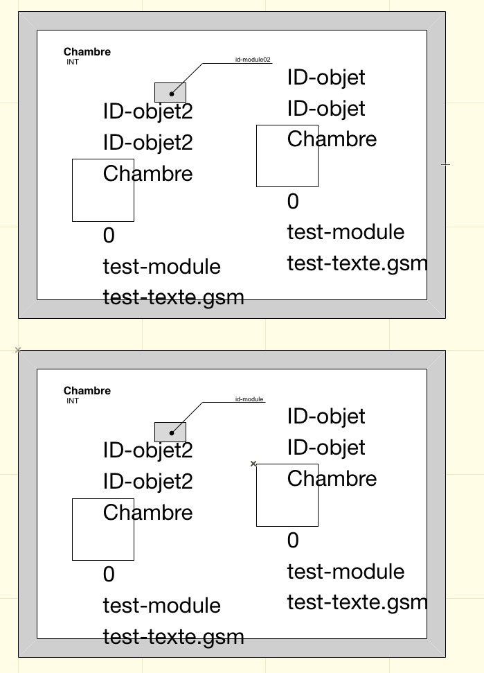

    Hi, in my object i want to write the ID object + the ID module,
    with glob_id i find the id object but never id module+ id object
    have you an idea ?
    id_string = “-”
    id_string2 = “-”
    id_string3 = “-”
    id_string4 = “-”
    id_string5 = “-”
    id_string6 = “-”
    l = REQUEST (“ID_of_main”, “”, id_string)
    m = REQUEST (“Zone_relations”, “”, id_string2)
    n = REQUEST (“Custom_auto_label”, “”, id_string3)
    o = REQUEST (“Internal_ID”, “”, id_string4)
    p = REQUEST (“Name_of_plan”, “”, id_string5)
    q = REQUEST (“Name_of_macro”, “”, id_string6)
    TEXT2 A/2, B/2+1.5, glob_id
    TEXT2 A/2, B/2+1, id_string
    TEXT2 A/2, B/2+.5, id_string2
    TEXT2 A/2, B/2, id_string3
    TEXT2 A/2, B/2-.5, id_string4
    TEXT2 A/2, B/2-1, id_string5
    TEXT2 A/2, B/2-1.5, id_string6

    Yes, but when i use Full_ID_of_parent, i have only the ID object not the ID module.
    in link file my object
    thank’s for your answer
