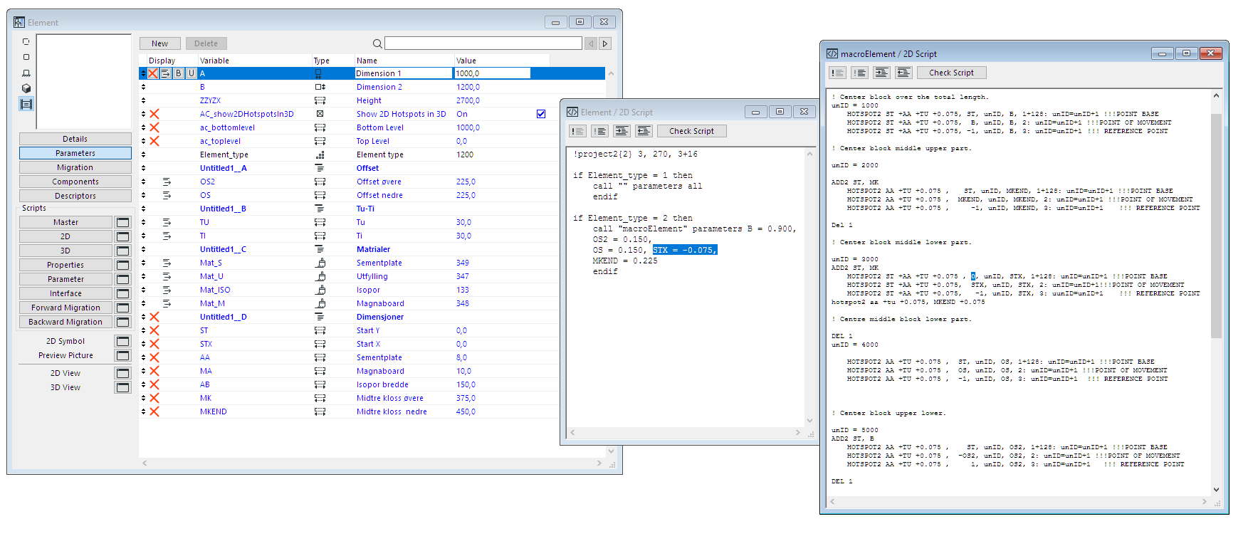

Laurits FrydenbergParticipantHi all.
I can tell that my problems solved now.
The solution was to use:
if GLOB_MODPAR_NAME = "ELEMENT_TYPE" then if ELEMENT_TYPE = 2 then parameter B = 0.9, OS2 = 0.15, OS = 0.15, STX = -0.075, MKEN = 0225 endif
I want to thank everyone lots of good help 🙂

Laurits FrydenbergParticipantThanks PĂ©ter Baksa
How exactly put it into parameter script Peter
I’m sorry I’m new to using GLD so I feel a little sillyLaurits Frydenberg
Technical drawing
Laurits FrydenbergParticipantThis worked but I thought that it was possible to put them out with a fixed value.
But it is not possible to lay them with a fixed value as the item is in the dimension I want to start with and then use hotspots to adjust it to a different value to the desired length.
If possible how I can do it?Laurits Frydenberg

Laurits FrydenbergParticipantThanks Joachim SĂĽhlo
I checked my script as you said, I try to set STX to zero. But that did not help either. As you see will become STX call parameter STX = -0.075 so when the item is also wrong when I want a 1200 element.
Have you or any other one idea on how I solve this problem.
Or whether it is possible to retrieve a GM file in its entirety into the file that I call element
Thanks

Laurits FrydenbergParticipantHere I have created an image that explains what is my problem.
Laurits Frydenberg
Technical drawing
What I need is to get hotspot2 funke after I change size with call parameters with new values. So I can fine adjust these in plan.
I have four different sizes for these and they are 1200, 900, 600, 450 mm long.

Laurits FrydenbergParticipantHello again Gergely Fehér
I try your suggestion, but when was length the same on the same on all four as I should have.
That I should have the length of 1200, 900, 600 and 450 mm and this is where I have to slightly adjust the lengths up door, windows and corners. Then it would have been easy to use hotspot to adjust the length.It’s possible I miss understood you. What I tried I was that I created two macros one that had parameters for the 1200 and the parameter 900.
The 1200 I used (call macro_navn parameter all) then works out everything as it should with hotspots.
But when I use when I use (call macro_navn parameter B = B, etc, etc, ..)
when the length the same as 1200 but I can use hotspots but it is wrong length.What am I doing wrong?
