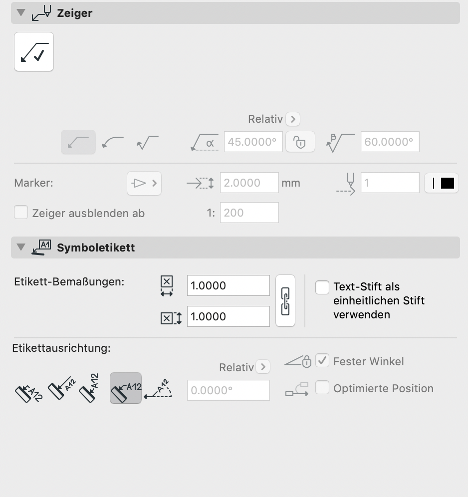

Manuel Emmenegger
ParticipantBut I could not deactivate all of them. Has anyone an idea, how I can solve that?
Thank you.Attachments:

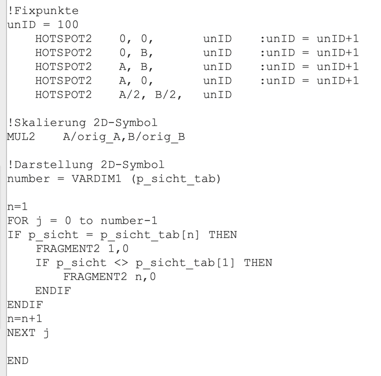

Thank you.Manuel Emmenegger
ParticipantHi Péter
We have a construction area with some buildings (building A, building B, building C). Know we want to place a survey map in the header of every plan, at the moment the
architect do this with the element below. He draw the survey map in the 2D-Symbol and change the list of the parameter “p_sicht_tab”. With the command MUL2 it’s possible
to change the size graphically, but I need the parameters orig_A & orig_B (At the moment we copy the parameter A & B manual in the parameterlist).
Maybe there is a better way to create this element, thank you in advance.Attachments:
