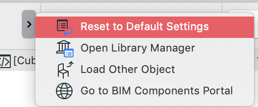

David Shorter44
ParticipantDefault parameters (those values set when the object is saved) can always be retrieved
see attached screenshot ‘resetToDefault’Attachments:
