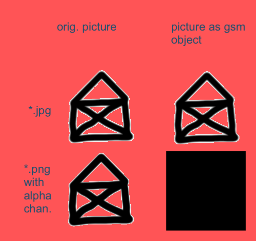

  • in reply to: MASK in UI_​PICT #4449
    Vojtěch Janda
    Hi Péter.
    I attach png and pln file.
    – I tested it in AC18 (windows and mac) and AC22 (mac). It is the same.
    – I paste the image into ArchiCAD and save it as a library object. In this object, I write a 2D description and description of the user interface. (If the image is not part of the object but as the separate object, then everything is fine – See the fourth example)
    Thank you very much.
