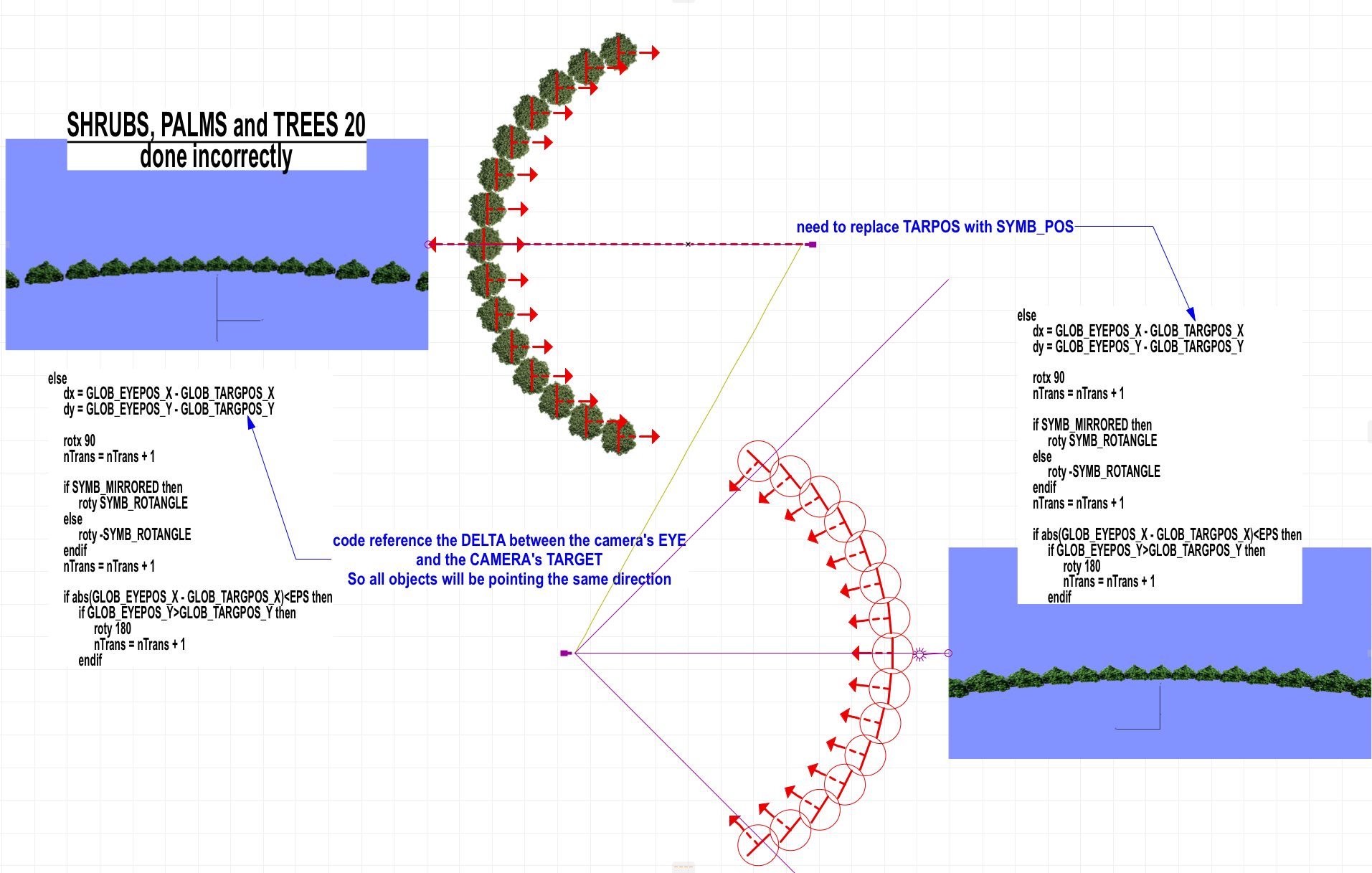

      Ok… Bear with me… I had brought this issue up with GSNA and they suggested that I post here. I get the feeling that they’re thinking I’m looking for GDL Help… when I just wanted to expose an error in their objects that auto rotate to the camera.
      Please see the graphic below and let me know what you think.
    • #2949
      Thanks for the report – but you’re right, it is bug report that should be handled within the normal support channels. Now you don’t need to go back to the support, we’ll check it soon.
