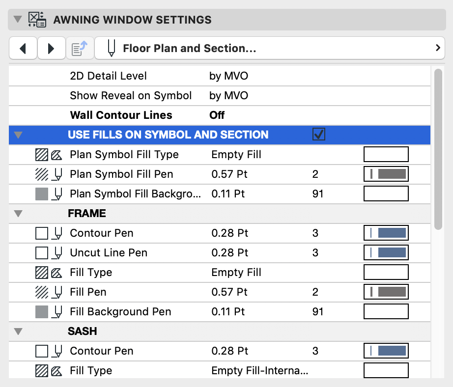

      How is the Floor Plan and Section settings page done? (In windows settings, e.g.) I don’t see anything in UI_LISTFIELD about flippy triangles.

      I think the macro that collects the all content and then showing it have tricked You..
      if listitem containts “0” in 4th position then it will be a group line (_stout is text dfined previously – in my current scripting manner)
      ui_listitem itemID, iFillListID, "", 0, "", _stOut : itemID = itemID + 1! Group Line
      if it contains 1 in the same position then it will be inside the group
      ui_listitem itemID, iFillListID, "gs_cont_pen", 1, "", _stOut : itemID = itemID + 1

      Yesssss! Thank you Piotr.
