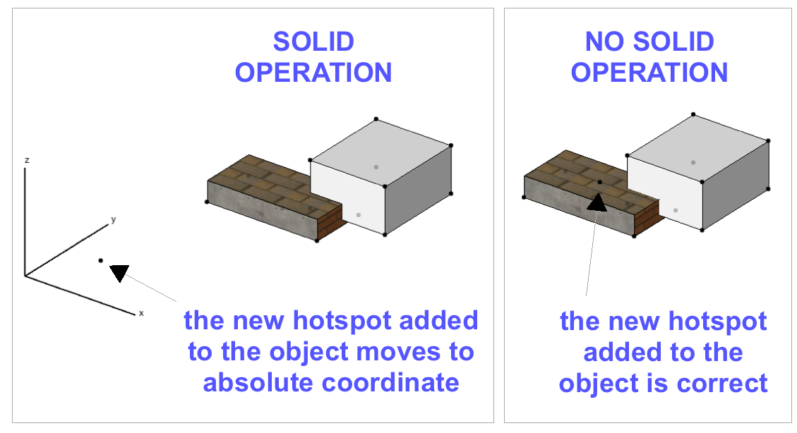

      This only an example. I have this problem in my 3DMD Railings in solid operation.
      The problem come out where I use PGON{2} or PGON{3} in solid operation; 3d Hotspos move to absolute coordinate.
      I create a simple object attached to replicate the problem.
      In the object, where are used PGON{3}, I added an hotspot in 3d.
      When the object is used for solid operation the hotspot moves to absolute coordinate.
    • #2105
      Thanks for the report, I could reproduce it and asked my colleagues to investigate the problem. I’ll come back later if we find any solutions.
    • #2135
      Unfortunately there are no workaround for that, it is a bug in ARCHICAD. We will try to fix it in an upcoming update and in the next version.
