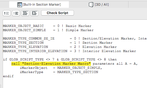

I did open Section or Elevation in the floor plan but I don’t know how to open macro this Section or Elevation calls so I can read it’s parameters. Please see screenshot below.

ParticipantSelect just the macro name inside the quotes and the OPEN the library part (CTRL+SHIFT+O on Windows machine).
Dell Precision M6800 - i7 4700MQ @ 2.40GHz, 16GB RAM, AMD FirePro M6100 (2GB), Windows 7 64bit-
May 16, 2017 at 08:14 #3244
Maciek Bajor
ParticipantThank you for your reply.
Unfortunetly nothing happenes when I select Section-Elevation Marker Macro or “Section-Elevation Marker Macro” and go CMD + SHIFT + O. This command normally openes object’s gdl editor when I do it on plan etc so I belive it’s the same function. I am on OSX.
May 16, 2017 at 08:40 #3246
ParticipantThat should be the correct shortcut (works for me).
Make sure you are only selecting the name inside the quotes and not the quotes as well.
If the shortcut doesn’t work you can use the ‘Edit GDL Library Parts’ toolbar.Barry.
May 16, 2017 at 09:15 #3248
Maciek Bajor
ParticipantWow that works! Thank you Barry!
I pulled out toolbar you suggested. Thanks, a lot. Have a nice day 😉
