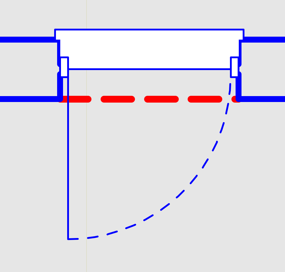

      I have door object that I made a fill to cover slab lines where there is a threshold stone. This fill also seems to overlap part of the wall line and the automatic renovation filter demolished line.
      Is there a way I can set the fill to be under the wall, but above a slab?
    • #2681
      Dominika Bobály
      You can try to draw back the covered wall parts using WALLINE2 command. To get the attributes, the globals containing the necessary information are different in case of a simple wall (WALL_SECT_PEN, WALL_LINETYPE) or a composite wall (WALL_SKINS_PARAMS).
