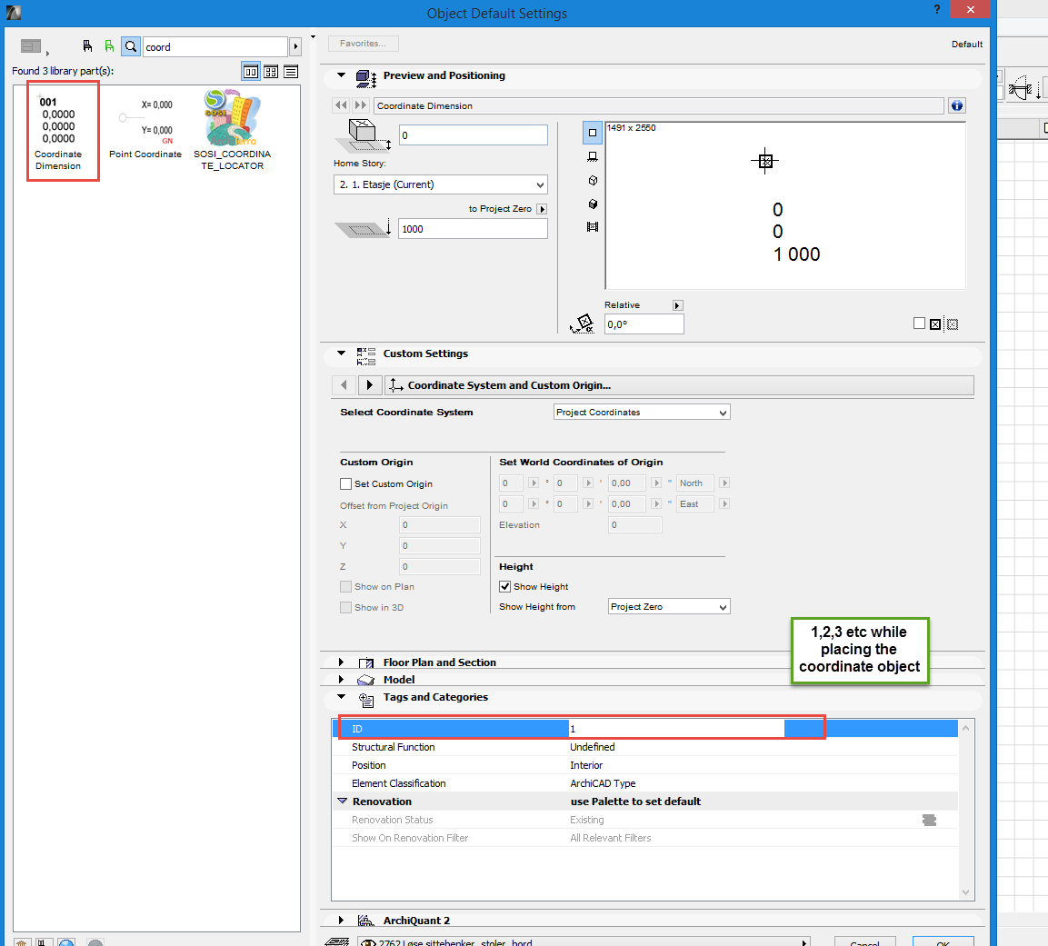

Thanks for your fast answer 🙂 I tried this but cant simply get it to work with the coordinate dimension. The ID box was checked by default. I am using AC 19 and the norwegian template. Se attached pictures.
Tried both in ac 18 and 19 and the other coordinate dimension. Please let me now if I am doing something wrong.
