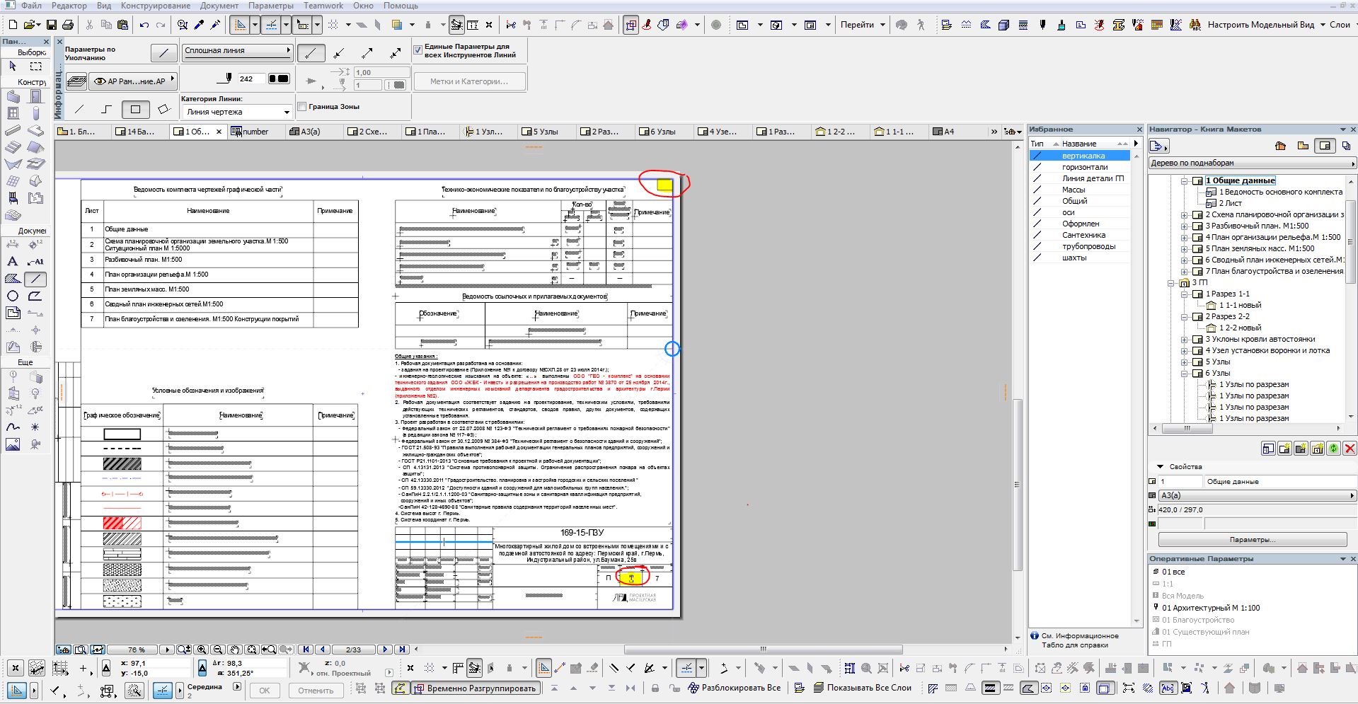

I wonder, it’s possible to script a setting of id in layout book. I’m need to make ID, which is start numbering from variable number (Exampl: ID of layot is 12, but i need make it to 35, 23 – is start number). Difficulty in the fact that i need also have an workable autotext #Layoutid, to mark the number of list.

ParticipantI’m need to do this
