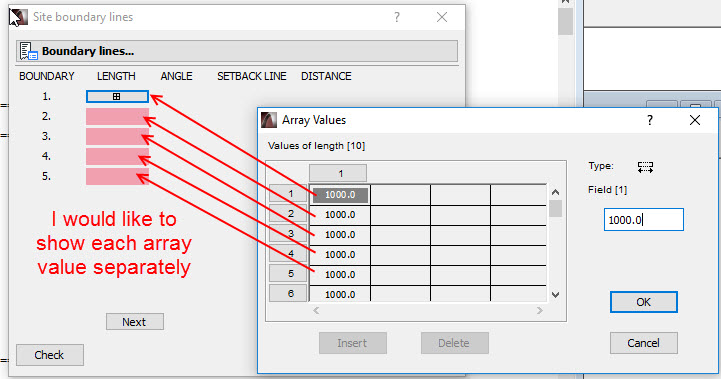

      I have an object that draws site boundary lines (all nice and stretchy).
      It has a length parameter that is an array containing the lengths of all of the boundary lines.
      I would like to display each individual array value separately in the graphical interface (see attached image).
      Is this possible?
      I hope I am missing something very obvious.
      I have had no luck with UI_INFIELD “length” – I just get all of the values in one button.
      UI_INFIELD “length[1]” does not work.
      I can use UI_OUTFILED “length[1]” to get un-editable text of the value – but I can not format the text to hide the unwanted decimal places.
      Does anyone have any ideas?
    • #4363
      It’s all OK.
      I have it now.
      UI_INFIELD{2} length[1], 70,20,65,15
      UI_INFIELD{2} length[2], 70,40,65,15
      {2} and no quotes did the trick.
      I am sure I had tried that already but obviously not.
      I was sure it could be done.
      Everyone can relax now – panic over!
