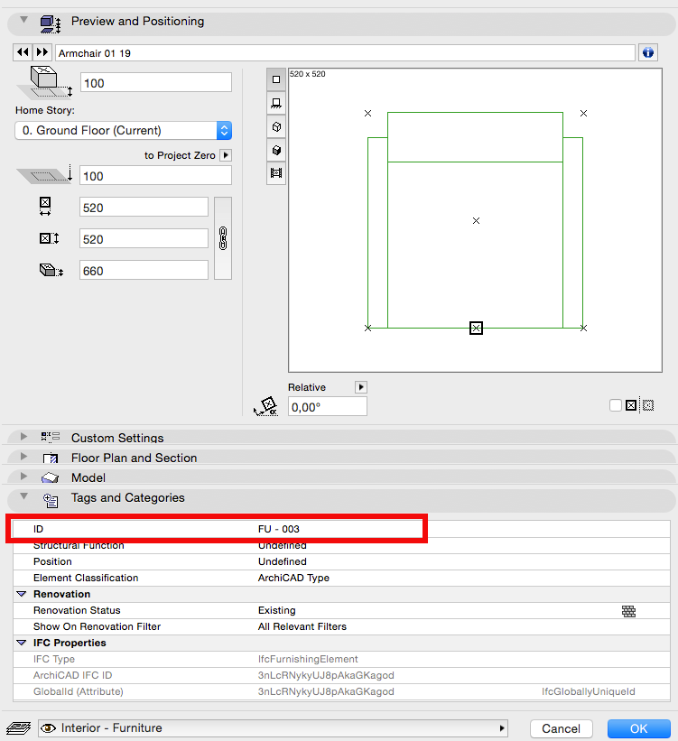

      Hi,
      There is no solution in GDL for that: an object does not know anything about previously placed objects.
      I think you should use the ID instead, which makes this increasing for you automatically, and you can check the ID from your scripts and draw that from 2d script.
