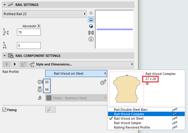

    • #4808
      I attached a screenshot of the “Profiled Rail” UI. The popup is an infield of a profile type parameter, in the red box you can see the size of the profile. This is done automatically by Archicad.
      In the blue box there are two outfields based on variables returned by the request. The request itself can be in the UI or the master script.
