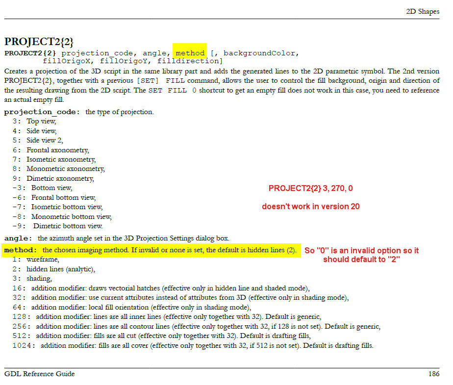

      I feel this is a bug as it works in all older version and is documented in the GDL reference guide that it should work (see attachment).
      If the ‘method’ variable is set to ‘0’ (i.e. invalid variable) then it should default to ‘2’ but it doesn’t.
      It just doesn’t project anything at all and gives no error messages.
      So … PROJECT2 3, 270, 0 … doesn’t work.
      Same for … PROJECT2{2} 3, 270, 0

      Thank you for the report, our in-house investigation confirmed the bug as well. We will take care of it in the normal process.

        the bug has been fixed, it will be included in one of the upcoming regular updates (probably the next). Thanks again for the report.
