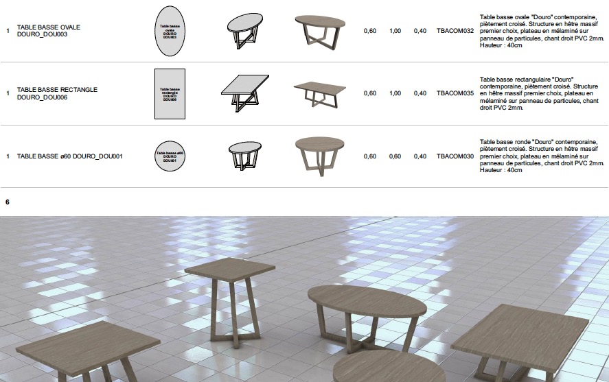

ParticipantHI, Text variables are blocked at 250 characters.
My object descriptions are longer
How to avoid this blocking?Tonio

ParticipantHi thanks for your answer, but I can’t use it in a variable parameters.
I need to add long description for my objects (more than 250 carac.).
have you got other solution for long description in a variable parameters ?Tonio
