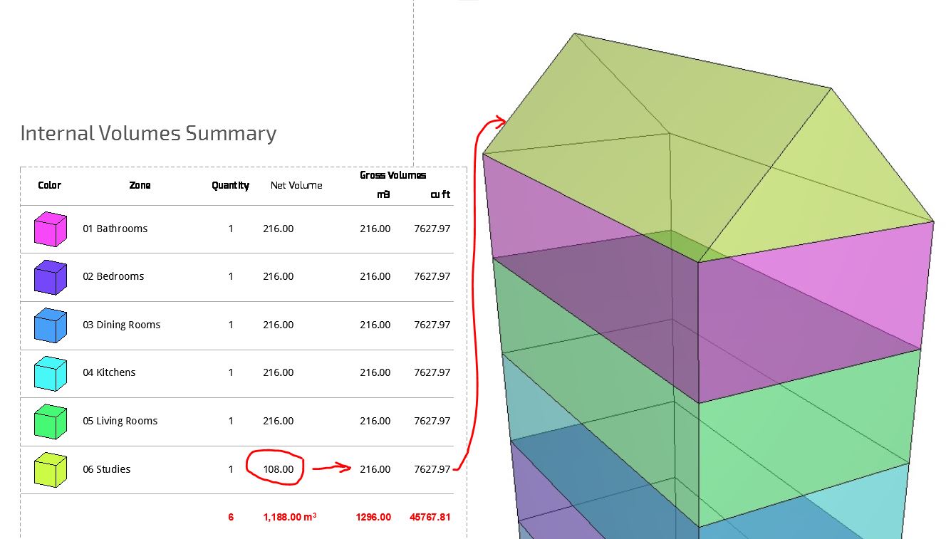

      Hello, I have added some parameters to the Zone stamps to automatically transform metric measures to imperial, as we frequently need to list both i our schemes.
      My problem is that the calculations are not working correctly when crops or solid elements operations are involved. Please refer to the attachment to view the issue.
      Thanks.

      ROOM_VOLUME parameter always stores the gross volume of the zone, before the subtractions. For the first check, it seems the net volume is not available from GDL scripts.
