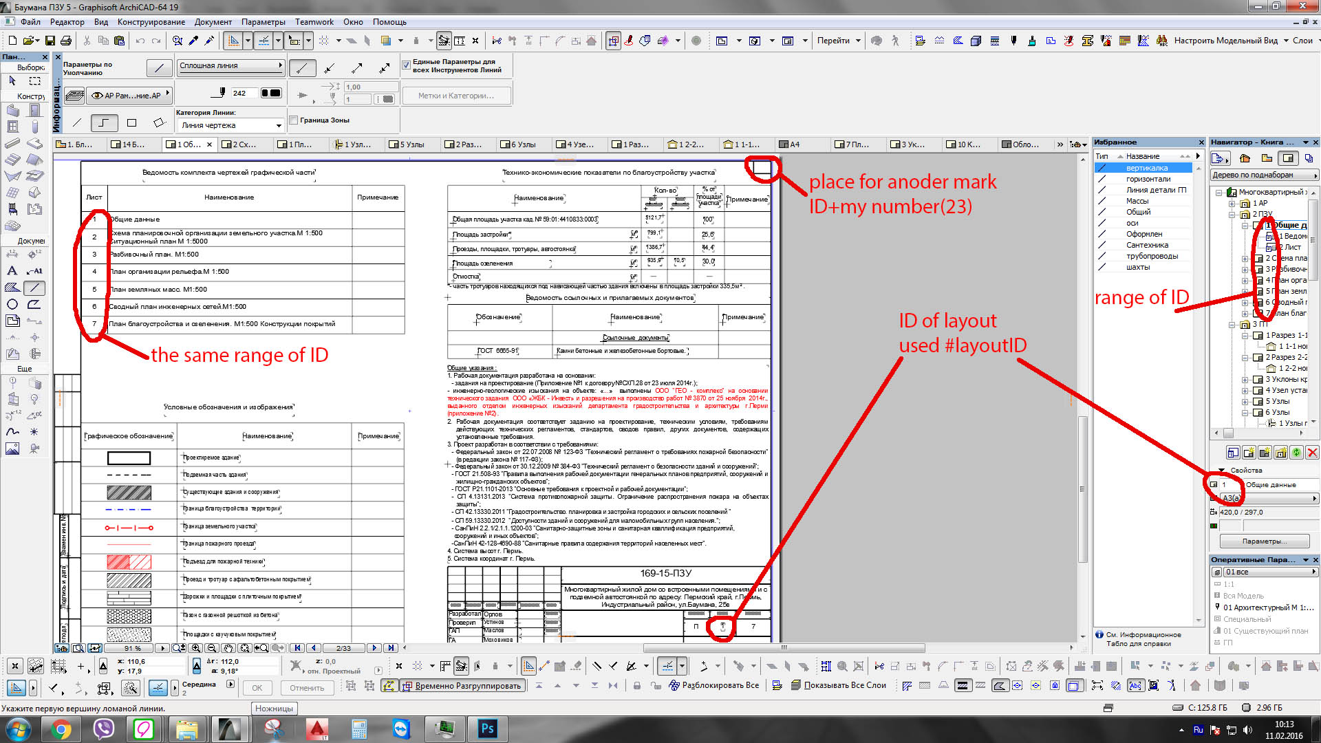

  • in reply to: ID of layout #2246
    Илья Орлов
    I’m need to do this
    in reply to: ID of layout #2245
    Илья Орлов
    I use this
    temp=REQUEST (“HomeDB_info”, “”, homeDBIntId, homeDBUserId, homeDBName, homeContext)
    txt1=datetimestring
    txt2=index+pop
    txt3=homeDBIntId+pop
    Pop – this is my variable start number
    But script don’t use “homeDBUserId”(layout id) as arithmetical number (“homeDBIntId”(global ID) – used as number)
    Can I convert “homeDBUserId” to number?
    in reply to: ID of layout #2221
    Илья Орлов
    Is it possable to make this
    1. Mark layout by autotext(numbering = id of layout in layout book)
    and at same time
    2. Mark the same layout(and start ID from my nuber 23)
