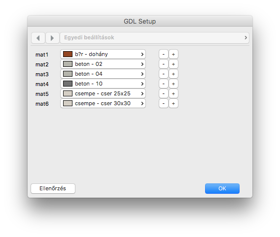

I have a “n” (1-10) looped 3D obejct.
I have 10 surface parameter. I control them with array.
I would like that the user can control with UI BUTTONS (+, -) the n parameter so when I push “-” button it delete a row, but the essence is that I don’t want to delete the row, I only want that every material parameters value would jump one place + or -.I hope I describe my problem well. I am so sorry, I get that it is not so much a forum theme rather my own defect that I cannot understand.

ParticipantAdd this to your code
parameters script
if GLOB_UI_BUTTON_ID <> 0 then
parameters n = n + GLOB_UI_BUTTON_ID
GLOB_UI_BUTTON_ID = 0
endifinterface script
for i=1 to n
ui_button ui_function, “-“, _x2+200, _y, 20, 20, -1
ui_button ui_function, “+”, _x2+220, _y, 20, 20, 1
ui_style 0, 0 :ui_outfield “mat”+str(i, 1, 0) ,_x, _y :ui_style 0, 0 :ui_infield vari_mat_[i], _x2, _y-5, _sx-200, _sy :_y=_y+_d
next iHTH 🙂
