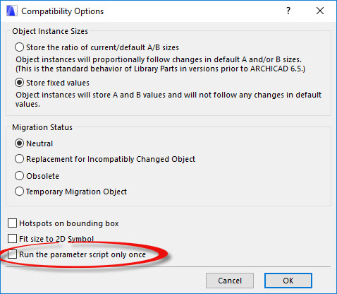

ParticipantAlso now in the Compatibility Options in the Details page there is an option to run the parameter script once.
I haven’t looked into this yet as I haven’t had the need.Barry.

ParticipantIn “compatibility options” you will need to switch to “Store fixed values”.
Then save object.For already placed instances you will have to change any parameter and then change it back before it will stretch.
For newly place objects it should work straight up.Don’t ask me why this is but I suspect it has something to do with the fact your hotspots use the “A” value – even though they are not changing it.
